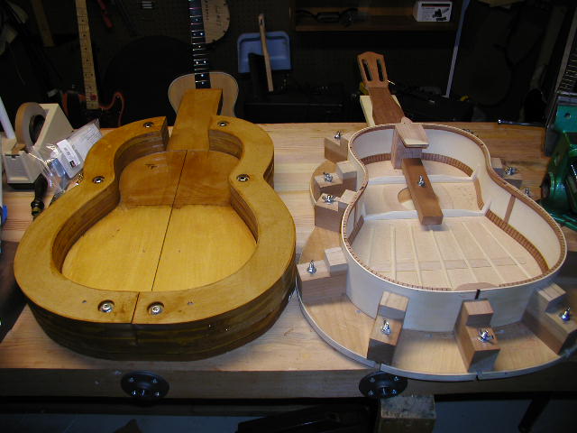

Ray - Bogdanovich uses an outside form (but a regular spanish heel).
He builds a workboard for his backs, but it is really just a radiused dish so I don't know why he doesn't use one. For the top, his sides are level through
the upper bout down to the lower transverse brace but transition to a 25' dome in the lower bout - a radius dish can be used to sand the linings there.
Jim
Jim Kirby
kirby@udel.edu
PostPosted: Tue Aug 14, 2007 12:59 pm
Posts: 2186
Location: Newark, DE
First name: Jim
Last Name: Kirby
Here is an example of the workboard according to Bogdanovich (build for a Romanillos plantilla - sorry no occupant yet) and the workboard according to Courtnall (with a Reyes-style flamenco awaiting it's back). The Bogdanovich method sure does take a lot more prep work.
